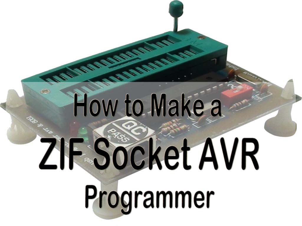

                      توضیحات به همراه لینک دانلود نقشه مورد دوم مورد دوم، البته بنده تست آزمایش نکردم.
                      Universal Programmer for AVR's and S51 Plus ZIF Socket !: This programmer has been designed by the company and has been produced at least 2500PCS of this and it's quite tested and standards and now we don't manufacture this version any more , here is the link product (Sorry only Farsi was available) Univer…
