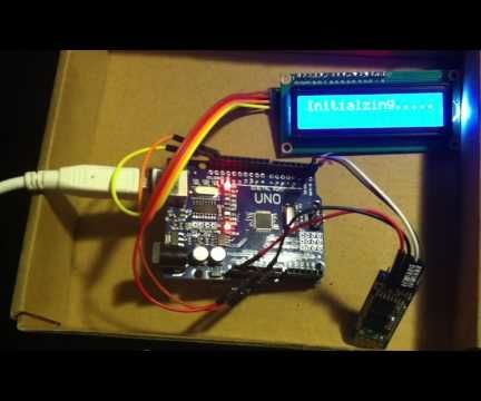

        بسکام اطلاعات ندارم ، این لینک ساخت کار با آردوینو با استفاده از ماژول بلوتوث
        Arduino OBD2 ELM327 I2C-LCD HC05 Bluetooth: Intro This is a project of mine that I wanted to share with anyone that is interested in same thing that I was. I just wanted a simple output of the Coolant Temperature data that the ECU already has in its memory. That's easier said than done. Sinc…
        و این لینک دستگاه رابط obd خودرو
